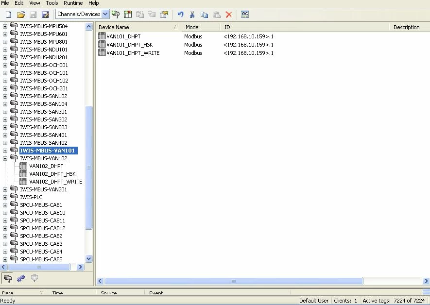

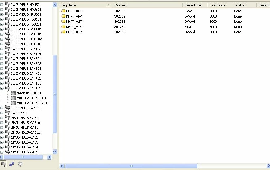

Kepserver scanning modbus devices, each channel has three devices preset, which all three have the same IP and ID.
Port 502 is used. Setting 1 socket per each device on channel is set.
I am getting big number of connection timeouts and random data collection disabled. All timeout/retires settings are already maxed out.
Attached are event log from offshore live system, some screenshots to present config from demo/test system and a .csv export example of one device from three on one channel.

There are also a lot of "Device not Responding" errors in the log. This means the KEPServerEX application is making a request, but the device cannot handle the request. It's possible the device is having a difficult time handling 3 simultaneous connections.  In order to optimize communications, it is recommended to have a single device per channel. Are you able to test this by reducing the 3 devices you currently have configured down to 1 device and see if the communications improve?
You may want to go into the device properties and increase the Request Timeout setting which will allow more time for the device to respond.

@cmorehead Thank you for your response.
As advised I will try to create new Kepserver configs with one device per one channel. I should have some window to test it on live system in a week or two.
Request timeouts/retires are already maxed out in the device settings.
