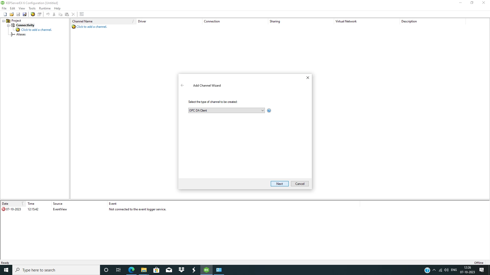

I have installed this software on windows 10 pro OS. Whenever i try to select the driver in connectivity option like OPC DA client/ UA client the application window gets exited without any error.

@ST_10406357,
Are you able to upgrade to the latest release of KEPServerEX v6.14. I recommend rerunning the install .exe for version v6.0.2207 and select remove. Next run the install of v6.14 by right-clicking on the .exe and selecting run as administrator. The v6.14 .exe can be obtained from the my kepware portal. Here is a link to the my kepware login page:
