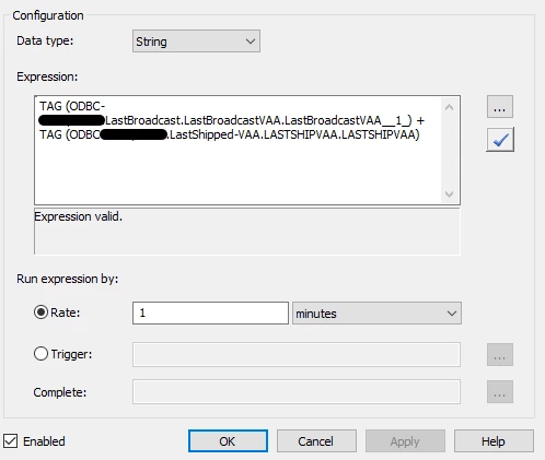

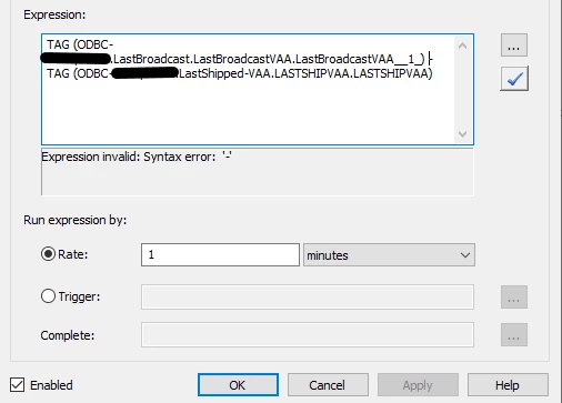

KEPServerEX 6.15 Derived tag: Addition is valid but substraction is not?
Derived tag: Addition is valid but subtraction is not? PTC support acknowledged this back in August but refuses to respond to my ticket. Screenshots attached..
cmoreheadAnswer
@JC_8933733
You are correct, subtraction is not permissible and would have to be handled by PLC logic or in the Client application
