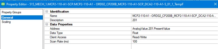

KEPServerEX 6.17 - BACnet - Quality is shown as good timestamp updates but value is old.

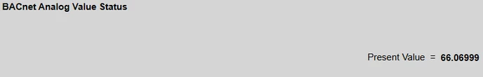

In the BACnet software WebCTRL the value is 65.88 but in KEPServerEX the value is 66.
I forced to read and the timestamp updated but the value remained the same. I thought it was rounding it or something. I changed address to a different temperature that did show decimal places and it updated to that point's value and showed decimal places. I then switched the address back and only after doing so did it show a current value with decimal places.
It's a little concerning that the value was shown as good and the timestamp having updated but the value  seems to be old.
Is there a bug in the BACnet driver or possibly some weird dead band?
In WebCTRL the value is currently 65.71 and is fluctuating a tenth of a degree every 5 or 10 seconds. In KEPServerEX it's just stuck at 65.86 and no longer seems to update. The polling rate is very slow but again if I force that one value to read or wait for the normal polling the timestamp updates but the value doesn't update.
I just tried doing it again and my trick of changing the address to another point didn't seem to work. That must have been coincidental.
Currently in the OPC Quick Client it shows 65.86
But in the BMS application it's 66.06.999

Is there a deadband involved ?
Tanquen12-AmethystAuthor
Aug 5, 2025 5:43 PM UTC
I don't see one associated with any of the points. No scaling or anything. Not something I've ever tried to add in KEPServerEX. The BACnet pulling is slow enough, I want it to read a new value whenever it does.
There are a few more settings on the device itself like timing and scan mode but I'm not aware of anything that would be telling it to ignore a change in value.

Out of many points it only randomly happens on occasion with a few points.
I did notice that the points in the BMS application have a COV of 0.5, is it possible that KEPServerEX is updating the values outside of that change of value dead band?
I tried changing the COV mode from the default of `Use Unconfirmed COV` to `Do Not Use COV` and the value remained the same.
I guess that should be expected if KEPServerEX is polling the BACnet devices more often than the building management system.
