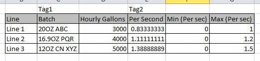

I am working on POC for which I need to generate simulated values using kepware. Requirement is to simulate production volume in gallons per second for each batch in production plant. Kindly refer screenshot for reference.
Tag1 : random number in range 0 and 1 per second
Tag2 : Custom Name in word and linking together to generate (Tag should be in string format e.g. "20OZ ABC")
Kindly, suggest  how I can achieve this.

It sounds like the architecture you described can be achieved using the Kepware Advanced Simulator. Here is a link to the Advanced Simulator product page and manual:
https://www.ptc.com/en/store/kepware/drivers/advanced-simulator
https://www.kepware.com/getattachment/d48765c8-8d5c-4d65-9a01-95be9cd5ee75/advanced-simulator-manual.pdf
I recommend opening a Support Ticket with the Kepware Solutions Consulting team to assist with set up prior to purchase. Here is a link to the page where a ticket can be opened with the creation of a free my kepware account:

Thank you Chris by going through the documentation now I am able to complete the requirement.
