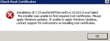

when trying to install KEPServerEX I'm getting the error:
"The Installer was unable to find required root certificates"
Do you know below mentioned instructions on installing root certificates incl. which are the relevant ones?
2021-10-27 22_49_56-2021-10-27 18_52_39-frasappprodis01 - Remotedesktopverbindung.png ‎- Fotos.png

Read this article - "Installation fails because of missing root certificates in PTC Kepware Products": https://www.ptc.com/en/support/article/CS321323

Oct 28, 2021 9:08 AM UTC
Yes, this worked !
Here the direct link to the article referenced in the one you provided:
https://www.ptc.com/en/support/article/CS292168
many thanks
