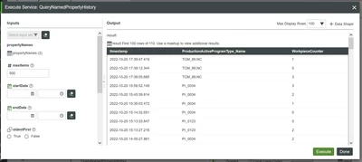

Yes. Kepserver is sending values every seconds...but QueryNamedPropertyHistory shows this result:

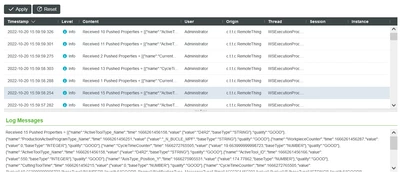

In monitoring section we can see that we are receiving values every seconds.

Can you show all the binding aspects please of the property and the binding itself.
It does look like if it is set to always, it should log each time, you can also try to set a subscription on the property and validate that it fires each update.
Worst comes to worse, if the subscription shows it firing properly, maybe use that to log the values.

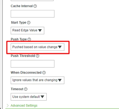

Hey @aetxeberria,
Just change the configuration of the Property in the RemoteThing of Thingworx.
Change the PushType from Pushed based on the value change to Always pushed.
Before:
Change to:

The configuration of the properties is Always pushed, but QueryNamedPropertyHistory does't show all values.

When you expand the 'Advanced' what is 'DataChange' set to? Value or Always?
