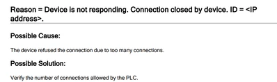

We are working with PLC Siemens S7-1500 Firmware v4.0. OPC is able to establish connection but at some point it disconnects and gives following error: "Device is not responding. Connection closed by device". Slot and rack in configurtion is correct.

Assuming you're using the Siemens S7 Plus Ethernet Driver — in version 6.18, we added support for S7-1500 devices with firmware version 4.0, so you should be covered in that regard.
I reviewed the manual, and based on the information provided:
  • Possible Cause: The device refused the connection due to too many connections.
  • Suggested Solution: Verify the number of connections allowed by the PLC.
Kindly check this configuration and see if it resolves the issue. If the problem persists, capturing a Wireshark trace may help us understand what’s happening at the packet level.
Please let me know how it goes. Thanks
