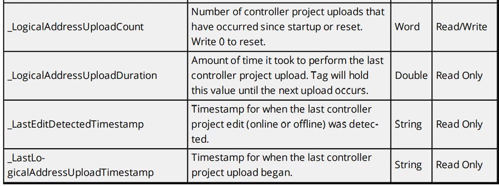

Additionally, you can monitor the state of the re-sync through the use of these internal tags:
Please note that these tags and Event Log messages are only in the v6.8 releases of the product.
