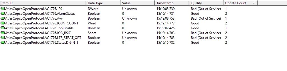

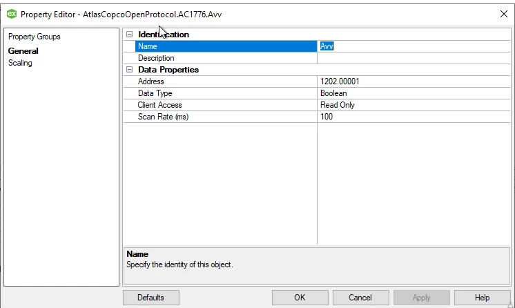

I need to configure kepware for reading Atlas Copco PF6000 data.
I set as model connect "open protocol".
When I set the parameters for "Data Properties" and then access the Quick Client, I see the connection has a "Bad (Out of Service)" quality.
KEPServerEX 6.12. V6.12.325.0
Anyone could you help me?
Please find image attachments.
Thank you,
Best Regards

Hi could you share your EventLog and Device configuration?

Hi everyone,
I was able to link several tags and read the value. I still can't read the value from the custom tags.
Could you help me with the configuration?
I need to read the tightening steps.
Thank you,
Best Regards
