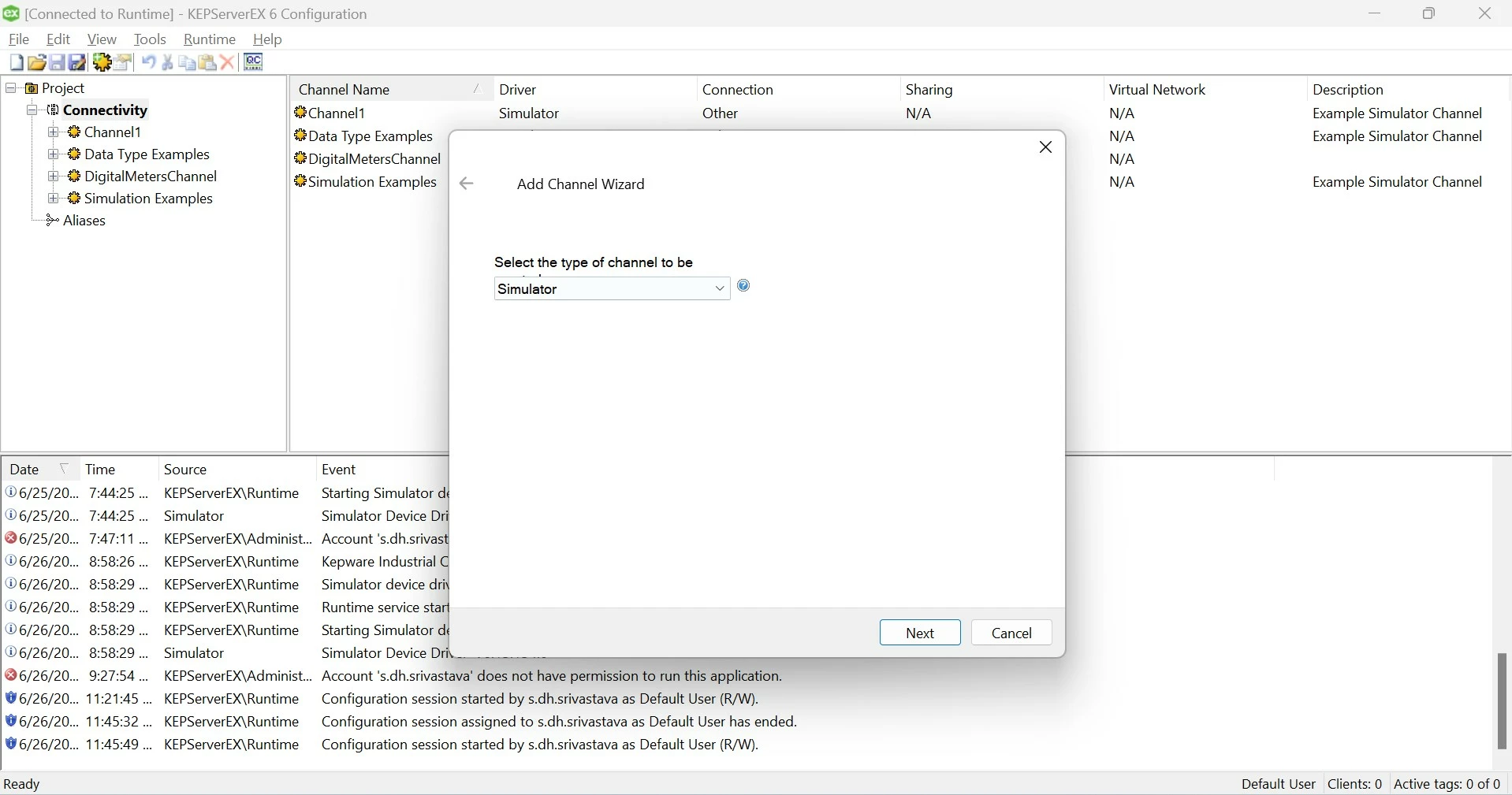

Kepware Channel is showing only simulator channel. Other channels are not available.
Hi Community experts,
I need to create a Modbus TCP/IP Ethernet channel in KepServerEx6 but I am not getting any option to select the channel. It has only simulator type channel available. Could you please help me troubleshoot how to configure any other channel in my kepware.

Jun 26, 2024 6:35 PM UTC
Please check the solution with link given below
https://www.ptc.com/en/support/article/CS286418
