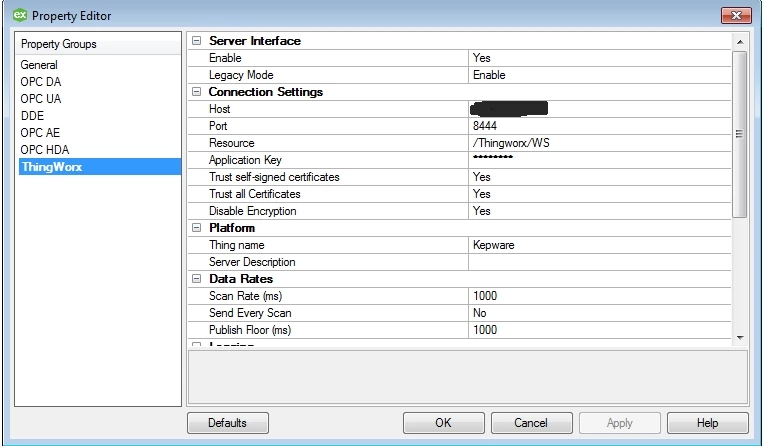

I have a problem with the connection between Kepware and Thingworx 7.x, and I am running out of ideas. I have set up this previously between Thingworx 8.x and Kepware, but I can´t find how to do it on the older version.
I have downloaded the Kepserver extension from the marketplace, added it on the composer and generated a Thing based on that ThingTemplate.
Then I have configured the Project-> Thingworx on Kepware as shown on the image. I know the port is the 8444 since it is the one that I use for connecting to the composer (I have several webservices running on the machine). I have added an AppKey that I created on Thingworx to the Application Key field, and the "Kepware" is the name of the Thing that I created using the Kepware extension as ThingTemplate.
After setting it like this, I am getting a "Could not establish a websocket connection" error all the time (second image)

When you browse to ThingWorx Composer are you using http:// or https://
The setting Disable Encryption: Yes means you should be using http://
The other thing to check is the appKey is not expired and does not have an extra <cr> at the end. Using copy and paste sometimes adds extra characters.

karnoia1-VisitorAuthor
Thank you very much! In all the explanations that I saw, the Disable Encryption had to be "Yes", but on my case that was the problem. I tried changing all the other parameters, adding rules to the firewalls, then taking down the firewalls completely, trusting certificates, etc etc. But I didn't think that on my case I needed the encryption enable.
