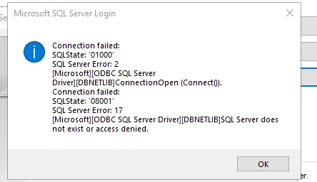

Hello community,
I'm using kepware with Datalogger connecting to a SQL Server.
When Kepware runs the data logger, the following error occurs.
Log group ~ Unalbe to connect to data source 'Kepware_DB_TEST'. Reason : SQL server does not exist or access denied. Connection Open(Connect()).
Kepware and the database are on the same IP subnet, and SQL Server Express is being used. I requested the company to open SQL port 1433, but they said it's meaningless because they are on the same subnet with only the last octet different. I'm not sure what I should be checking.
When I performed a telnet test from the Kepware server to the database server on port 1433, I received the error message: 'Could not open connection to the host, on port 1433: Connect failed.'
Any suggestions or things I should check would be greatly appreciated.
