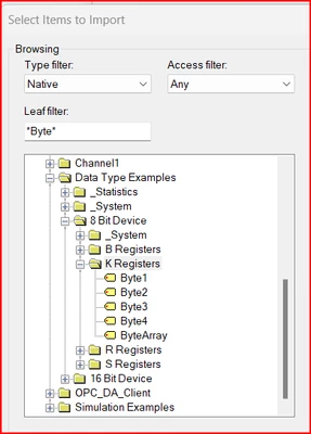

Using the Simdemo project installed by default, I added an OPC DA Client driver channel to look at tags that included the word 'Byte' as shown here:
When browsing to add tags for import using the leaf filter, type in the filter you wish to apply first, then expand the node tree and it should only display tags that match the filter you have entered,
-Andy
8 replies
Oct 8, 2024 7:35 AM UTC
Oct 8, 2024 11:31 AM UTC
Wildcards can be used before and after the text entered.  Also, the leaf filter is case sensitive.
-Andy

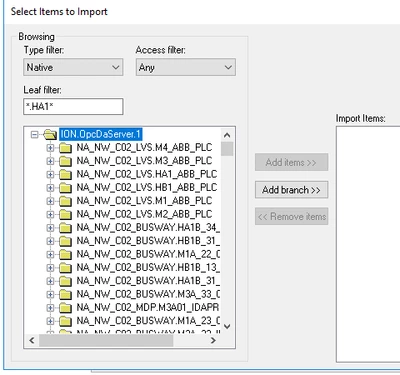

Oct 14, 2024 9:30 PM UTC
Hi Andy,
I tried the following filter, i still get all the results.
Can you tell me what im doing wrong?
