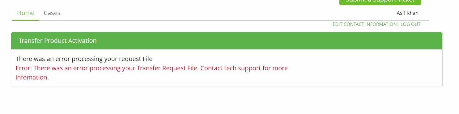

Hello community, i used emergency license before my server Raid failure, Is it possible i can use again the emergency license and back system online?

Hello!
Emergency license only have the validity of 7 Days from its activation date.
We can reuse Emergency license activation but prior to that we have to release it from current system.
I have seen the attachment, and it seems there is an issue with Transfer file.
Please open a support ticket on mykepware.com and we can reset the license from our database.
