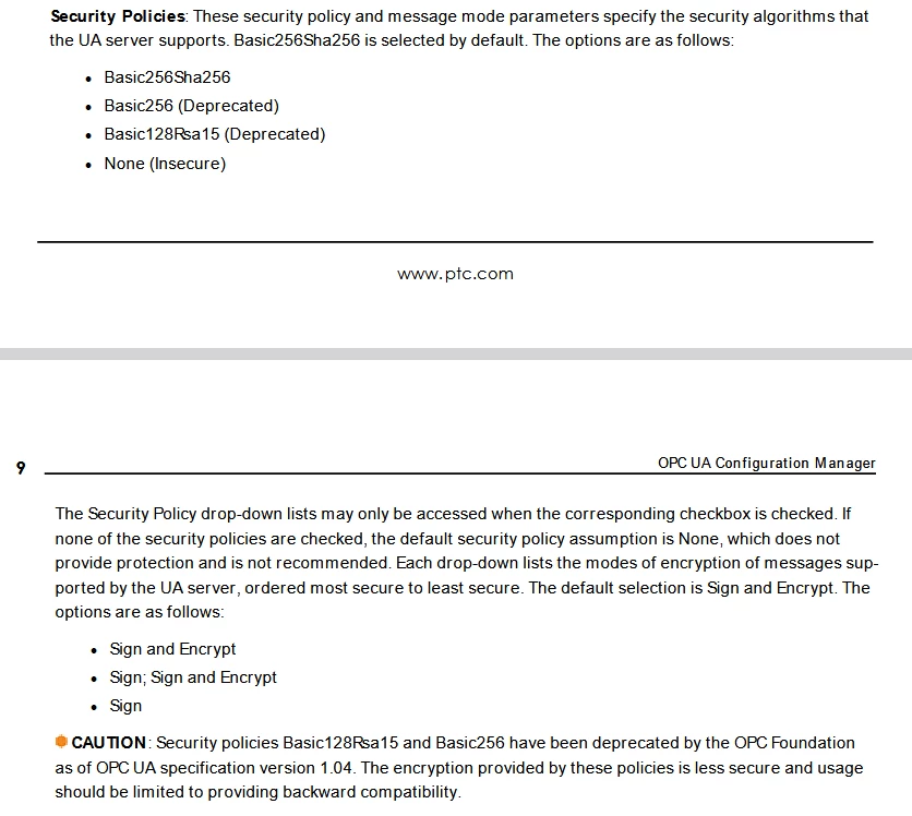

Kepware OPC UA User Manager: What encyption is used when passwords for user accounts are saved?
Kepware OPC UA User Manager: What encyption is used when passwords for user accounts are saved? Addtionaly, is there a way to force the user to have to input the old password before entering new? Currenlty its is greyed out

Found the following mention in the manual:
