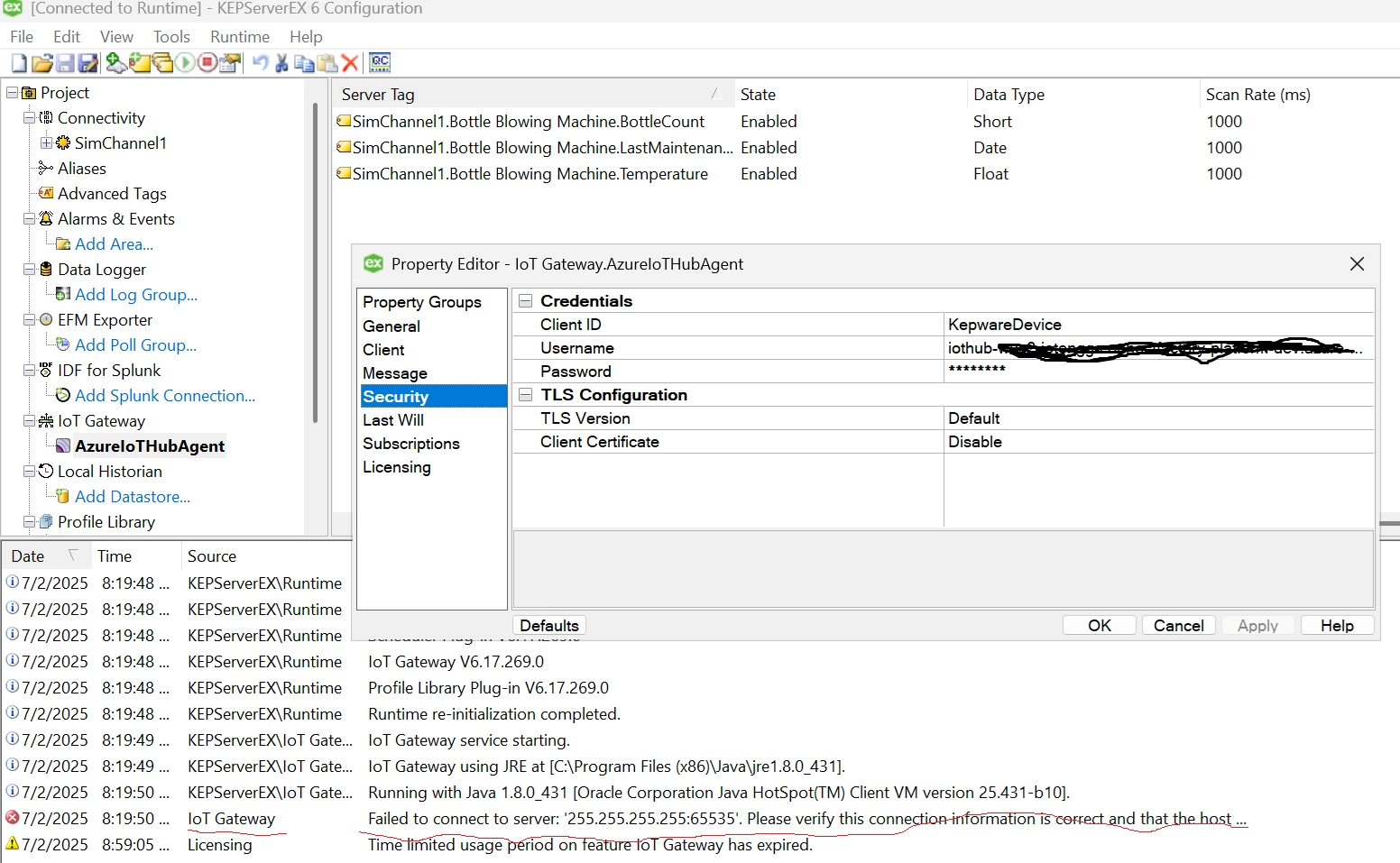

Issue: KepwareServerEx 6 failed to connect to Azure IoT Hub and device.
Environment:
  KepwareServerEx 6
  Channel: Simulator
  Added a new Device : SimDevice1
  OPCUA Tags :
        1. Temperature / R1001 / Float
        2. Counter / R1010 / Dword
  I have enabled OPCUA Setting by right-clicking "KepwareServerEx" --> "OPC UA Configuration".
 Then I have right Click on IoT Gateway and added new agnet with the below configuration.
Broker URL: Enter ssl://[IoTHubName].azure-devices.net:8883.
Username:  [IoTHubName].azure-devices.net/[DeviceID].
Password:  Primary connection string Ex: HostName=iothubXXXXXXX.azure-devices.net;DeviceId=iothub-XXXX-device;SharedAccessKey=XXXXXXXX=.
Client ID: My Device ID (e.g., KepwareDevice).
Topic:  devices/[DeviceID]/messages/events/ for publishing telemetry to IoT Hub.
QoS: Set to 1
Keep Alive: Default is 60 seconds.
I also open Windows firewall port "49320" and also verified OPCUA output in Prosys OPCUA browser "opc.tcp://vm-XXX-XXX:49320"
Still, kepware failed to connect Azure IoT Hub with the following error :
" Error IoT Gateway Failed to connect to server: '255.255.255.255:65535'. Please verify this connection information is correct and that the host can be reached."
Any suggestions why it failed to connect to Azure IoT Hub and Device?

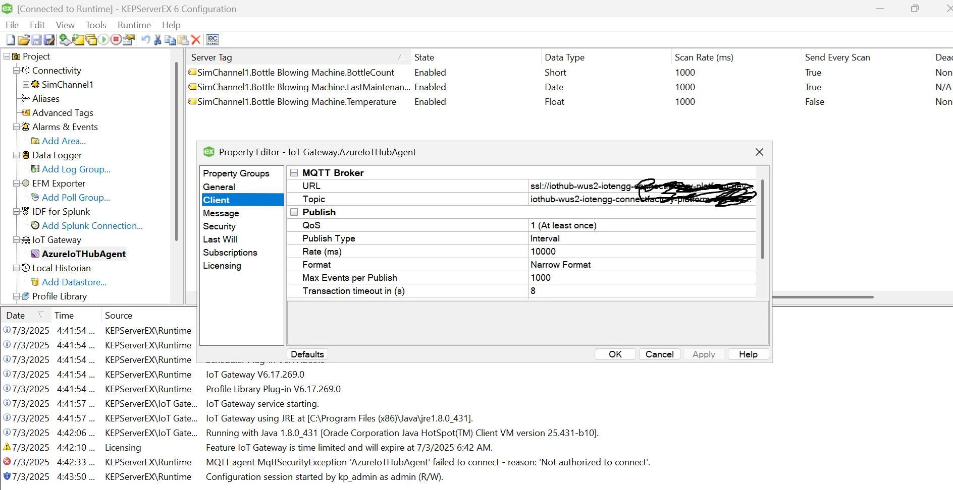

Below configration solution work for me.
URL :
    URL: ssl://[iot edge device FQDN]:8883
Topic:
     devices/[device id]/messages/events/
Client ID:
      [device id]
Username:
       [iothub long name]/[device id]/
Password: [SAS Token]
     Use MS Visual Code extension Azure IoT Hub to generate SAS Token.
   SharedAccessSignature sr=XXXXXXXXXXXXXXXXXXXXXX
Open windows Inward firewall port 8883. I hope this will help someone.

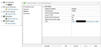

Note:- Please verify the Network Adapter is set correctly, The path is Agent -> Properties -> Server -> Network Adapter
If you have any questions or need further assistance, please feel free to contact us.
Thanks for the help.
My KEPServerEX 6.17 Non-Licence Copy.
I cannot find the below path in the properties of the IoT Gateway agent.
In the agent properties, "Server -> Network Adapter" is missing.
Please refer to the attached screenshot of my agent's properties.
Greetings @SW_10703260,
I hope you're doing well.
The "Network Adapter" setting is only available when the agent type is configured as a REST Server. If your agent is not set to REST Server, this section will not appear.
