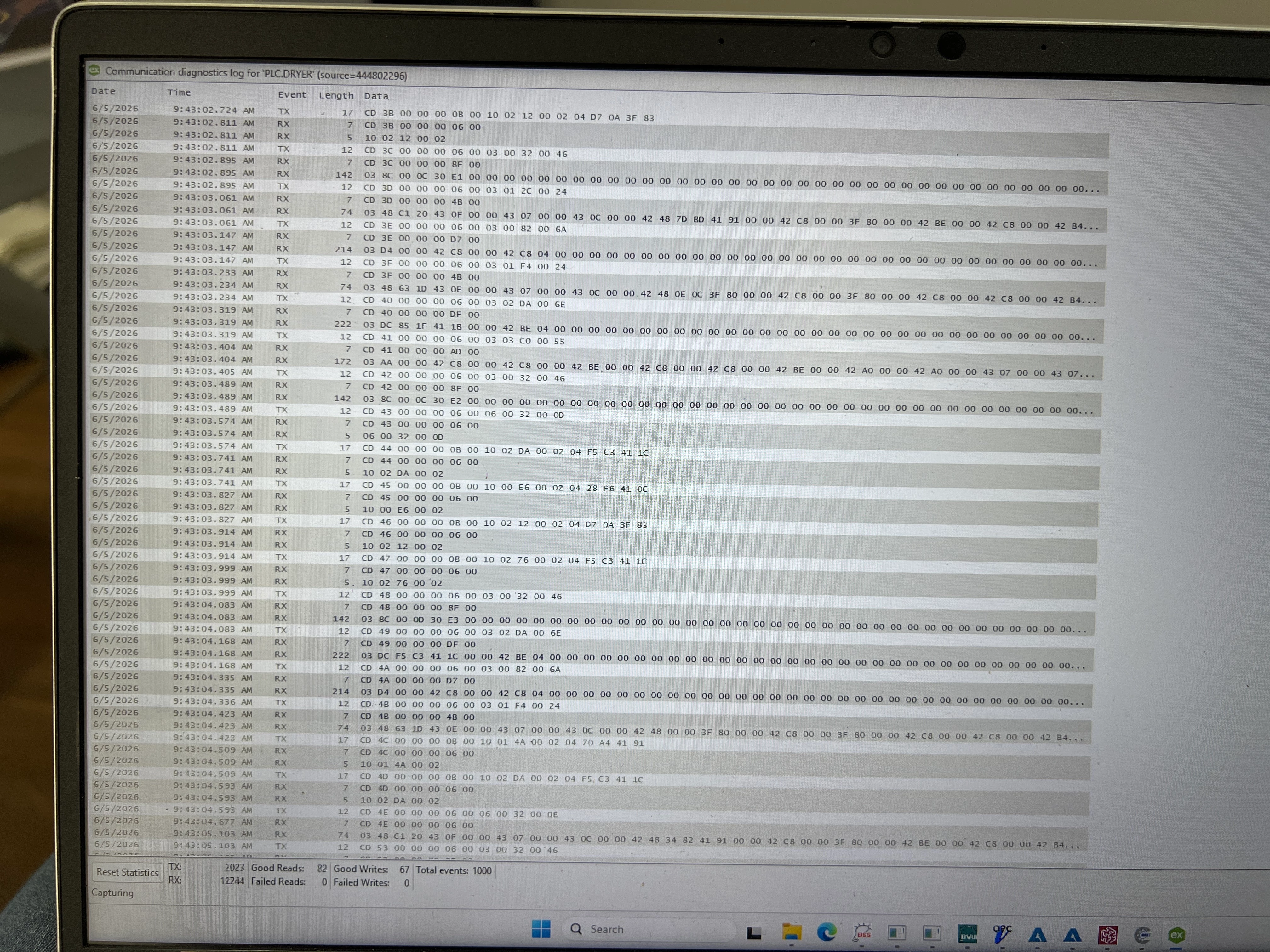

Hello, i’m facing an issue with KepserverEX6 not updating values according to specified scan rate (1000ms)  from a Modicon M580 PLC. Modbus TCP/IP driver is set, i’m using 241 tags, i use only one channel and one device. Instead of 1s i see values update roughly 5-15 seconds.
There are no other clients in Kepware communicating to the same device, only one OPC UA client reads/writes the same data from localhost (soft-PLC installed in the same server where Kepware is). The same soft-PLC in parallel reads/writes data in a different channel (Simulator Driver), and there everything is okay. So i don’t think issue is coming from the soft-PLC.
When i use quick client on the Modbus TCP/IP channel i also see data updating slow.
Network card is 1gbit.
My channel settings that could affect the communication are following:

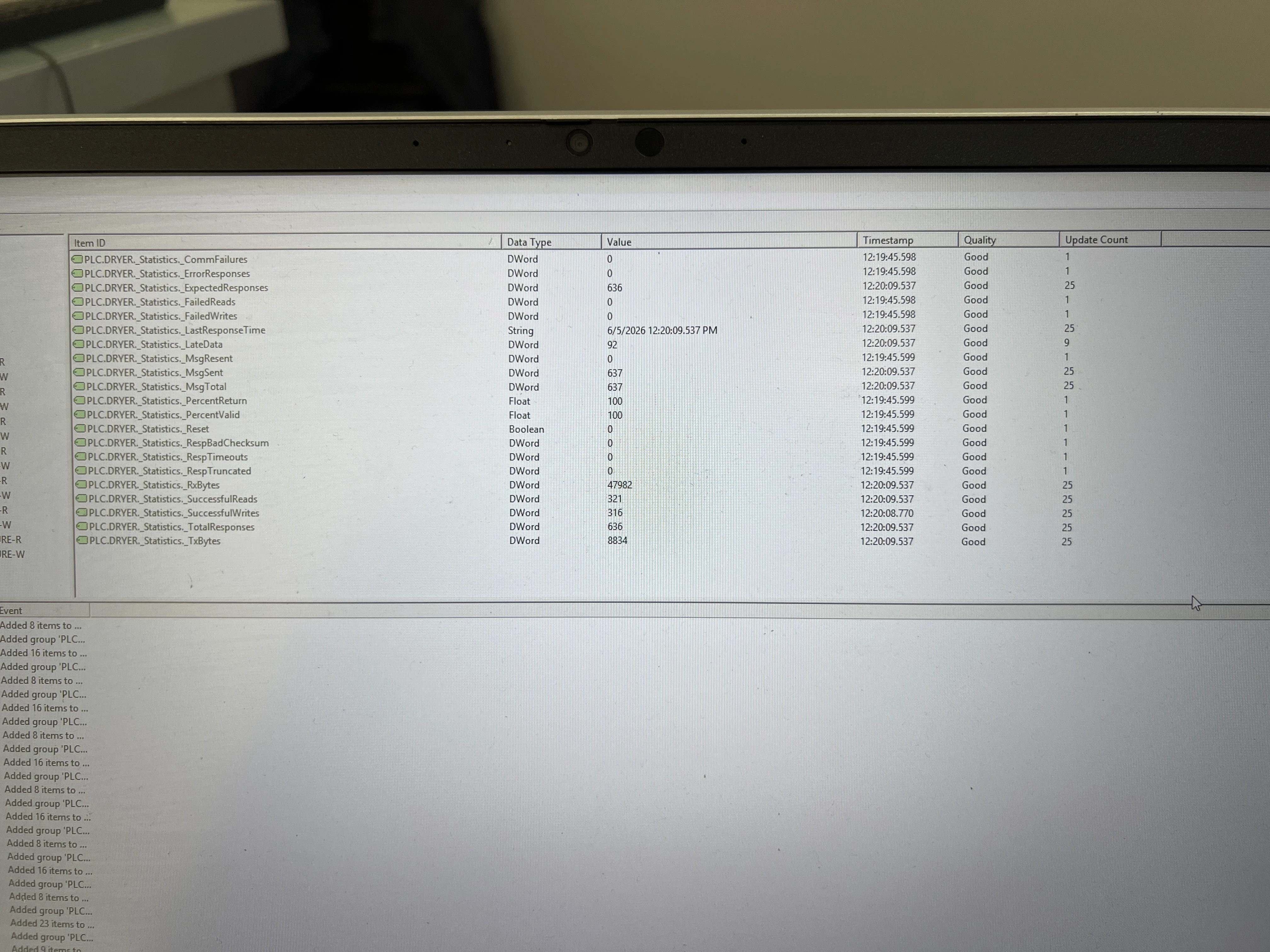

I’ve tried also increasing block sizes to 120 for IR and HR, 240 for OC and IC, reduced the  request timeout to 600ms, attempts before timeout to 1, i’ve set the scan mode to request data no faster than the scan rate (1000ms).  Data in the HR modbus registers is mostly grouped consistently in range of 100- 1200. This managed to bring down the time to 4-6 second of lag.
I also noticed in diagnostic that driver is sending  tx and recieves two rx responses in roughly 100ms, i guess this means the PLC is responding quite fast and network is not the issue. But also what i see is alot of tx/rx requests in a single second. This is how the diagnostic is looking. I have no errors but still have late data, but less than what i started with.
