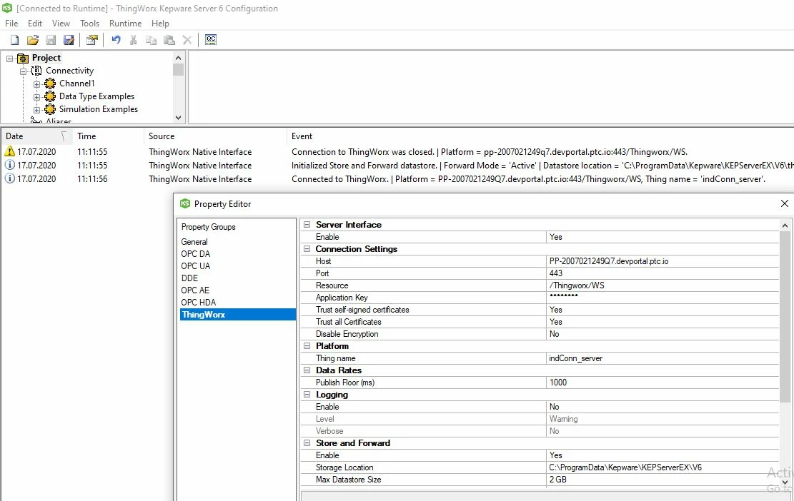

I am trying to connect Kepware Server to thingworx Fundation.
I am able to establish connectivity between Kepware and TW fundation however, when I try to read tag it says "Tag not connected"
Any advise

Hi @Pramodmahadik.
For the benefit of others in the community, this issue was resolved by reinstalling ThingWorx.

@Pramodmahadik  Hi,
Could you please double check the steps followed for connecting Kepware to TWX from the below link
https://support.ptc.com/help/thingworx_apps/r8.5/en/#page/thingworx_apps%2FThingWorxAppsSetupConfig%2Fconfigure_communication_with_kepserverex.html%23
And confirm  regarding a "connection toThingWorx appears" in the Event column .
If feasible please attach the screen-shoot of kepware side logs .
Additionally please let me know the value of  IsConnected Property for the IndustrialGateway .

Hi Gunjan,
Please refer attached snapshot. I have done configuration as stated on sample project link.
Also the Event column shows "Interface Connected to Thingworx"
Date Time Level Source Event
17.07.2020 11:11:56 Information ThingWorx Native Interface Connected to ThingWorx. | Platform = PP-2007021249Q7.devportal.ptc.io:443/Thingworx/WS, Thing name = 'indConn_server'.

IsConnected Property is True/Checked. However when I refresh it becomes False. Again when I save the IsConnected Property becomes true/Checked
