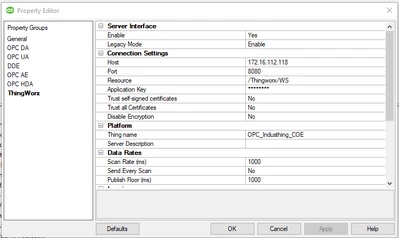

I have a thingworx instance where SSL certificate is not there. I want to connect that instance with a Kepware without SSL.
I have set Trust self signed certificate to false but still the connectivity is not established.
22-Sapphire I
August 16, 2021
Those three entries Trust./Trust/Disable Encryption
Try setting all of them to True
