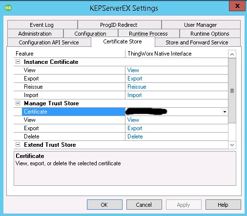

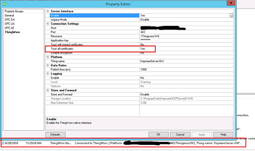

I'm trying to set up a connection between Kepware and Thingworx using the Native interface. I can connect when I turn on "Trust all certificates" over port 443.

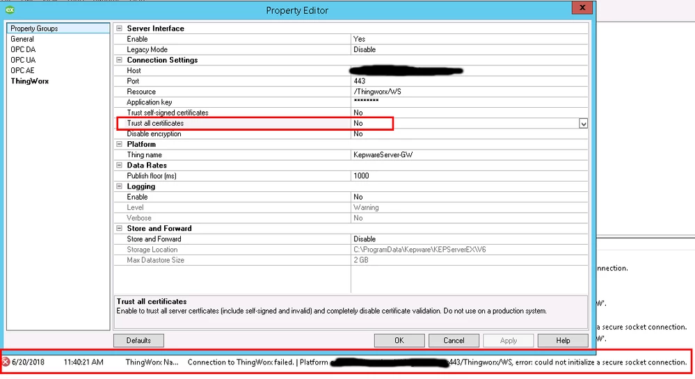

But now I want to disable this to have maximum security. In the Kepware settings, I have imported the certificate in the "Certificate store/ Trust Store" but with these settings, I still can't connect to the platform with "Trust all certificates" set to "No". I have also added the certificate to the trusted list in Windows but still no luck.
Has somebody experience on this topic? Can't seem to find documents to set this up.
