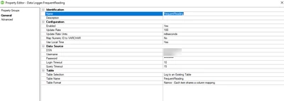

I am currently using KepwareEx in conjunction with the DataLogger plugin for recording data from PLCs and CheckWeighers. The process works seamlessly when I log the data to dbo.FrequentReading. However, I'm experiencing issues when trying to log data to Kepware.FrequentReading (Kepware schema instead of dbo schema).
Despite setting the default database and schema to Kepware for the user connection, the problem persists. Interestingly, Kepware does recognize the table and allows me to select it, but fails when attempting to write to it.
Furthermore, when I try to set the table definition to Kepware.FrequentReading, I receive an error message stating that the table doesn't exist.
