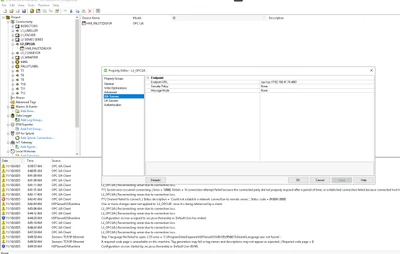

NO WAY to read Siemens TP900 OpcUA server

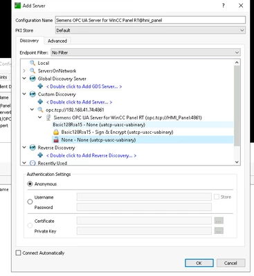

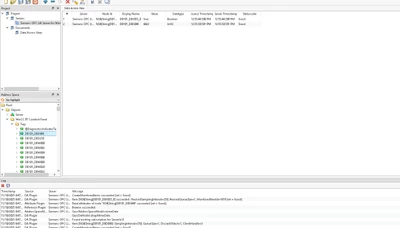

I have attempted to connect to the Siemens TP900 OPCUA server with kepserverEx and am unable to do so, but I have no issues with the Unified Automation UaExpert application:
With keptserverEx, I follow these steps but am unable to succeed.

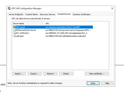

As it was not functioning in the certificates, I used the one I had imported Unified for OPCUASERVER, but nothing happened. I restarted the runtime and the server, but it still does not work.
