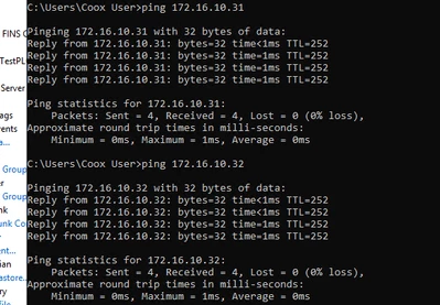

I recently started a project with 7 PLC (Mitsubishi C2J). Each of the device has its own channel. When I launch the QuickClient, only the first device have its tags quality at 'Good'; all the other have bad quality.
Also, in the logs, it appears that 'Device is not responding' for them.
The strange part is that, when I ping the IP addresses of the devices, all of them are responding well.
and the item ._system of the device that are not responding have ._Error boolean at '1'.
The last thing that I have noticed is that, when I change the IP address of the first channel to another one (ie, from .31 to .32), the new address of the device becomes readable in the quick Client.
I though it was an error in the channels parameters, but the all have the same parameters.
Need some help, thank you.

Hello Armand,
Device not responding is a common issue when configuring devices in the KEPServerEX application. Here is a link to the Kepware knowledge base article that covers initial troubleshooting of devices that are not responding:
https://www.ptc.com/en/support/article/CS276466
If the issue persists, I recommend opening a case through the my kepware portal of the website so that the Kepware Technical Support team can take a deeper dive into your configuration. Here is a link to the login page:
Log In | My Kepware
I can also create a case on your behalf if it is more convenient.
