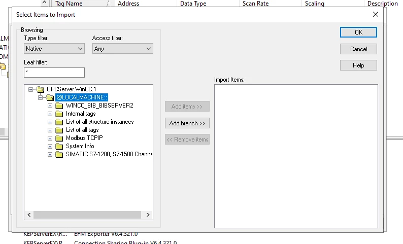

I'm Refsam Maulana, a technician who is working using the kepware application
I have a question about kepware, related to OPC DA Client on a domain system.
How to make computers that have different IP scopes, but in one domain to be read on the client's computer? Or is there a way to add servers manually instead of choosing from the Microsoft network?
Me and my coworkers still haven't figured out how to read the servers on computers that have different ip scopes but in the same domain.
Hoping to get a solution

Hello Refsam,
As long as the two machines (Client and Server) are on the same Domain and can ping each other you should just be able to configure DCOM per the following guide to get them communicating:
https://www.kepware.com/getattachment/04042e47-c690-467c-a931-a1ca126575db/Remote-OPC-DA-Quick-Start-Guide-DCOM.pdf
BRgds,
KC

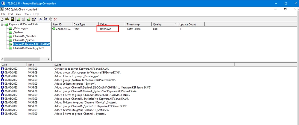

I have configured DCOM, but there is still a problem where the server tag can be imported into kepware but on the quick client, all values ​​are "unknown". Screenshot_8.pngScreenshot_9.png
Jun 8, 2022 3:12 AM UTC
a notification like this appears.
I've followed the way to solve this problem on PTC kepware, but it still doesn't work
