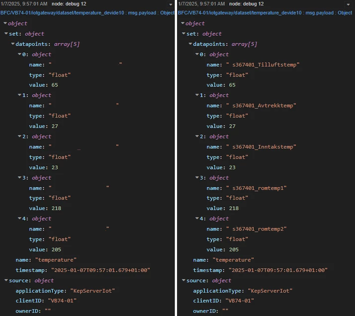

Here's the thing. The database receives the MQTT messages, but sometimes the |DESCRIPTION| goes blank, and stays blank until I manually stop/start every single agent manually. That fixes it, but only for a while... When the problem occurs, all messages are still sent and received, and contains the temperature |VALUE|s, but with the description blank, Grafana can't tell what's what and collapses all the temperature graphs into a single broken one. Also, there is always one or two agents who do continue to send their |DESCRIPTION|, even thought the rest of them won't. That fact especially drives me kind of nuts.😂
Just to clarify, here's an example of what the MQTT broker forwards to the database ("Intercepted" in node-RED). Left side depicts what it looks like when |DESCRIPTION| is missing, and right side shows what it is supposed to look like (and currently does).

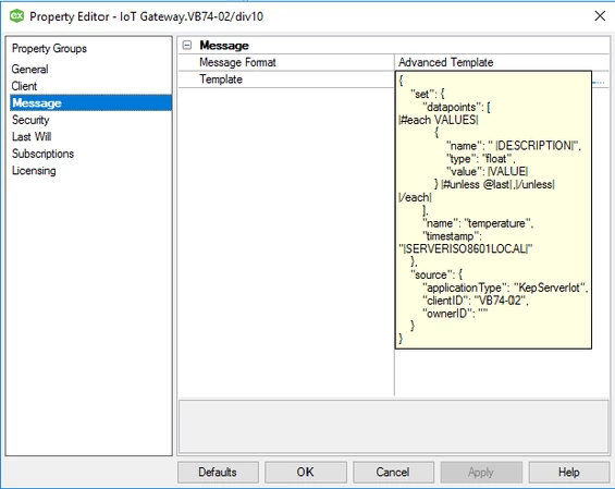

Here's how the message is set up in KEPServer (I have removed the leading space before |DESCRIPTION|, in case that was relevant).

I am one of the developers that added this content.  I am sorry you are running into this issue and it is very puzzling as to why the values are going blank.  Do you know of anything that is changing in the project when it starts sending the empty values?  I've been trying to think of what would cause it and maybe if tags were being added that had the same name.  That is just a guess.  Also on the side by side screen shot above it appears the blank version has spaces in it.  When the description goes blank does it send a bunch of spaces or an empty string?

But to your questions. Yeah, sorry, those spaces aren't really there (I should have mentioned that)... I was so dumb that I reset all the agents yesterday morning, instead of leaving some bugged for troubleshooting - They are all working as they should (for now), so I faked the right-side image in order to illustrate the problem. When the problem occurs, I think there is perhaps one space, so the name fields look like " ". I'd say this problem happened 4-5 times last fall. Last time I reset them was just before the holidays.

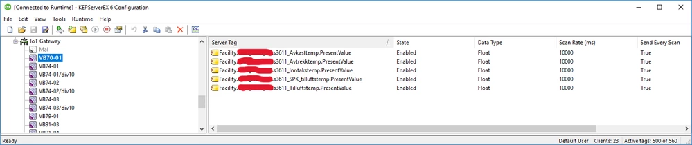

No changes should really be happening to the agents. No tags will be added, and all their tags have unique names. Or at least I think so, I might be mixing up terminologies. Here's an example:agent tags.png
So they all have the name 'PresentValue', but they are all in different unique tag groups.

No worries about the screenshot.  I thought that might be the case that's why I asked. 🙂 But knowing a space in there is good information.  There is a space before |DESCRIPTION| in your template so it is doing the substitution but there is nothing for the description verses something being wrong with the template.
