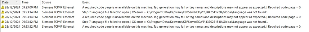

Please take a look at the following article as it may help resolve your issue:
CS293239 - Tag Import from the Step 7 project fails with error: "Step 7 language file failed to open" in PTC Kepware PRoducets
If you are prompted to log in to view the complete article, you can use your MyKepware login credentials.

Greetings @Ram_Boyapati,
I am writing to inform you about the causes behind the error you encountered:
  1. The computer is not configured with support for the specified Windows code page.
  2. The language file was not found.
To address this issue, please follow these steps:
  1. Install any necessary language packs to support the Windows code page character set.
  2. Try again on a computer that supports the specified Windows code page.
  3. Modify the Step 7 project to generate a language file.
Note:- When Language file was not found the value of required code page will be: 0

Can you please elaborate where to download the file and update. How to generate language file from step7 project.
Dec 31, 2024 5:06 PM UTC
Greetings @Ram_Boyapati ,
Tag import for the Siemens TCP/IP Ethernet Driver supports tag names and comments in the native character set as specified by the Windows code page in the Siemens STEP 7 project's language file. A missing, altered, corrupt, or incorrect Siemens STEP 7 language file may cause tag names and comments to www. ptc.com 19 Siemens TCP/IP Ethernet Driver import incorrectly. Utilizing the STEP 7 language-neutral option (which allows text to be entered in a different character set than what is used in the STEP 7 language file) may also cause tag names and comments to import incorrectly. The STEP 7 language file can be located in the Global sub-directory of the STEP 7 project root. Automatic tag generation may result in the display of incorrect characters if the necessary language packs are not installed on the system.
I would suggest you please coordinate with Siemens to download the necessary file and update it. Additionally, they can guide you on how to generate the language file from the STEP 7 project.
