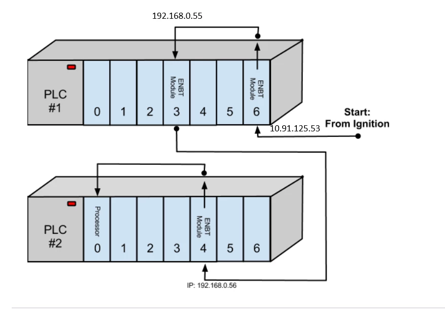

Hi
I want to connect the control logic 5500 into kepware using routing path. the first plc connected to the network same as the server and the second plc is connected locally to the first plc. can someone give me the device ID? see the attached screenshot
