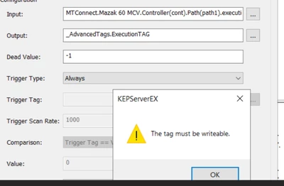

Hello all.
I have been trying to create an advanced tag by comparing the Logic_cond from a MT Connect Mazak Tag.
The idea is to populate PTCAvailabiltyFaultCode of DPM with this advanced tag. This advanced could be a bolean value; Whenever the Logic_Cond is "Normal" then it should write over this new tag as 1 or 0.
We have tried by using a derive tag, complex tag (we are still new to kepware ) but whenever we try to write this new "combined" tag it just pops up that the tag is not writeable.

@AG_10894350,
It initially sounds link you would need to use the Kepware Advanced Tags (Link Tag function). Here is a link to the page in the Kepware manual which covers the use of the Link Tag:
https://www.ptc.com/store/-/media/kepware-store/en/manuals/advanced-tags-manual.pdf#page=19
I recommend opening support ticket with the Kepware team to assist with your specific inquiry and architecture. Here is a link to the login page where a support ticket can be opened:
