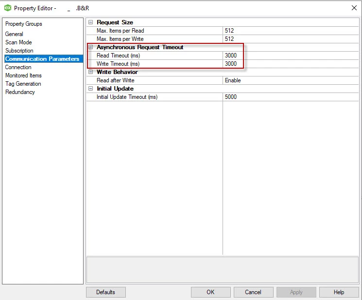

I have a problem connecting to some OPC UA Clients.
Sometimes I get this warning:
Warning OPC UA Client XYZ.B&R | Read request failed on device. | Status description = 'The operation timed out.', Status code = 0X800A0000.
When it happens some tags are in 'Unknown' quality and until I force a synchronous write the status cannot return to "Good" status.
I tried to change "Asynchronous Reqst Timeout", but increasing it immediately returns the value to the default of "1000".
Let me know please.
Thank you.
Regards

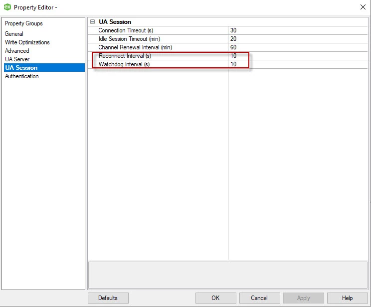

Aug 13, 2024 7:27 AM UTC
Hi Catalina,
During this time I have seen the error again from the logs however it hasn't generated a problem following the suggested changes and it also seems that the incidence is lower.
Thank you.
Aug 7, 2024 8:10 AM UTC
Take a look:
Aug 7, 2024 8:47 AM UTC
I had previously tried, but if the project remains connected the value is reported by default (I simply disconnected the project, made the changes, saved the project and reconnected).
Now I wait and I will let you know in the next few days if I have solved it.
I attach the images of the modified parameters (the value is not defined, so I put one to feel).
Catalina
