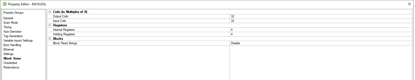

Hai sir,
          I tried with reducing block size in modbus driver settings. reduced from 32 to 4 and checked with 3 and 1 also. So still only 4 tags are showing unknown with bad tag quality also tags quality is good but reading same value in two tags and with zero values. I attached the image of setting page. Will it get resolved when reinstall the kepware or need to add all devices from scratch?
