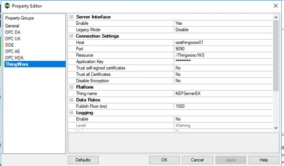

while configuring kepware to thingworx we are facing error "the connection requires a valid trust store, but the store is empty or invalid."
here is attached snap of property
I have checked application key is valid and having date of expire 2022 We have not configure SSL but still its throwing this error.

Hi @dpchavan.
It sounds like you're running SSL.  Here is an article that may help.
It may also be necessary to change the "Disable Encryption" flag to yes.
Regards.
--Sharon

Hi Sharon,
  Thanks for reply but we have not installed thingworx on SSL .and its fixed authentication type with navigate so definately its not on SSL.
