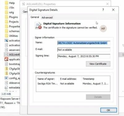

TKS: Unable to load driver DLL: C:\******\drivers\siemens_s7_plus_ethernet.dll
  1. Scenario: Upgrade from KepServerEX V6.11 to Thinkgworx Kepware Server V 6.16.217
  2. Issue: After migration, Siemens S7 Plus Ethernet driver does not load. Error message in Event Log: Unable to load driver DLL: C:\Program Files (x86)\Kepware\KEPServerEX6\drivers\siemens_s7_plus_ethernet.dll.After checking the digital signature of the dll, the certificate in the signature cannot be verified.2025-02-10_16h19_49.jpg
  3. Solution: There are 2 "dll" associated with the Siemens S7 Plus Ethernet Plus drivers:
  • AGLink40.DLL
  • siemens_s7_plus_ethernet.dll
Try to find on another PC/Server the certificate from the dll "AGLink40.DLL" with a "digital signature OK", then export this certificate and import it onto your server.
Reinitialize TKS, that's it that's all.
But Best Practice, when migrating from KepServerEX to Thingworx Kepware Server:
  • Backup your configuration
  • uninstall KepServerEX
  • Install Thingworx Kepware Server

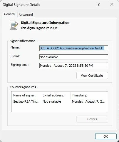

Hi @herve_husson ,
I assume the root cause would be:
The DLL file siemens_s7_plus_ethernet.dll requires a verified digital signature for proper loading. It depends on another DLL (AGLink40.DLL) which must also have a valid, verifiable digital signature. On some systems, the certificate for AGLink40.DLL may not be trusted or may be missing.
May be you can resolve by
  • Identify Valid Certificate Source:
    • Locate another PC/server where AGLink40.DLL shows “Digital Signature is OK” (see second screenshot).
    • This indicates the certificate is fully validated on that machine.
  • Export Valid Certificate:
    • On the working machine:
      • Right-click AGLink40.DLL → Properties → Digital Signatures → Select signer → View Certificate → Details → Copy to File.
      • Export the certificate (preferably as .CER file).
  • Import Certificate on Problem Server:
    • Double-click the exported .CER file.
    • Click Install Certificate.
    • Select Local Machine store.
    • Choose Place all certificates in the following store → Trusted Root Certification Authorities.
    • Complete the import.
  • Reinitialize Kepware Server:
    • Stop and restart ThingWorx Kepware Server services (or reboot if necessary).
