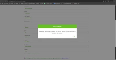

Mar 3, 2026 9:58 AM UTC
Thank you for the clarification regarding Kepware licenses not being tied to the MyKepware account used for activation or purchase.
I would like to clarify my situation further:
I created a MyKepware account (Account B) and used it to generate several Kepware licenses. I have now created a new account (Account A), and I would like those licenses to be visible under this new account.
Based on your previous response, I understand that licenses are not directly tied to the account. However, when attempting to change the email address associated with the original account, I receive the following error:
“Please contact support.”
I have attached a screenshot of the error message for reference.
Could you please advise:
  • Is it possible to change the email address associated with a MyKepware account?
  • If not, what is the recommended way to manage licenses under a new account?
    Thank you in advance for your assistance.
ntripathi16-PearlAnswer
Mar 3, 2026 12:47 PM UTC
Greetings @leekhil_kataray,
Please coordinate with our sales team ( sales@kepware.com) to update the email address associated with MyKepware account.
While Kepware licenses are not tied to the account used to activate them, the recommended method to move license visibility or manage licenses under a new account is to:
Transfer the license from the license utility using new MyKepware account, then reactivate the license. This ensures your licenses are fully manageable under the new MyKepware account going forward.
If you need any assistance with this process, please feel free to reach out.
