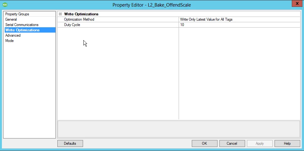

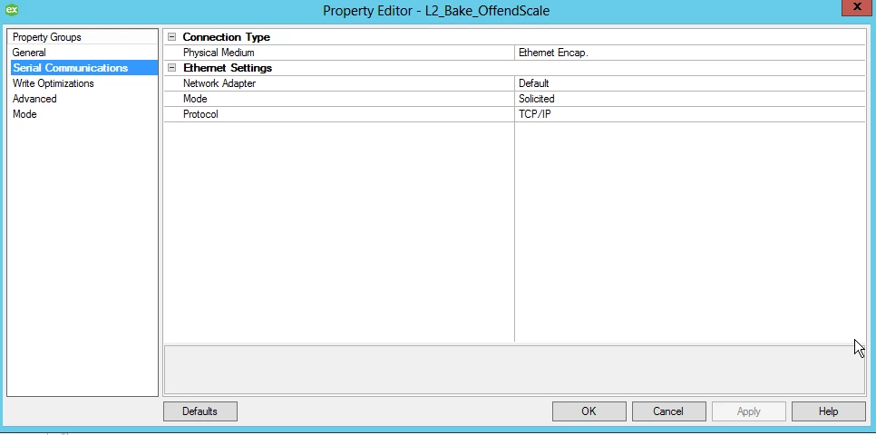

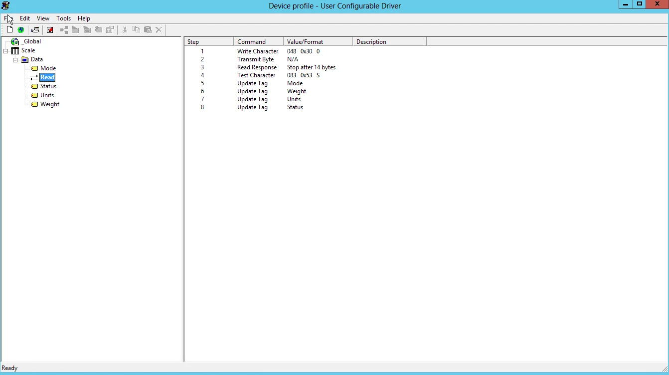

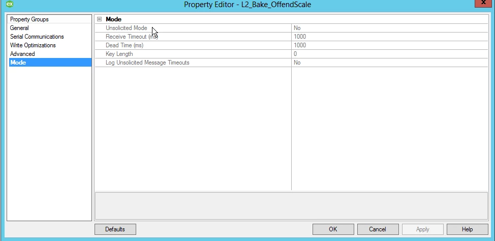

I have a UCON driver that is collecting scale data over TCP. The driver will work for a long time then suddenly stop working and begin displaying the data as "bad". When I connect to the device with putty I still receive the string data it is supposed to be receiving, but the driver is not collecting it or displaying any errors. When I reinitialize Kepware it begins working again. This happens randomly, it could be days or months before this will happen but it is a problem that I need to reinitialize since we are using Kepware for our data historian. I have tried using a stop character in the string received and have recently just tried stopping after a certain number of bytes, but I don't feel that is the problem since the stop character is always the same termination character.
  • What would cause the UCON driver to stop sending/receiving TCP messages without any errors?
  • Is there an error log somewhere for UCON drivers?
  • Is there any way to correct this?

The KEPServerEX Event Log would be the first place to look for clues as to why your instance is suddenly stopping. There are also communication diagnostics in the KEPServerEX application that can be enabled. The third-party tool called Wireshark can also be very helpful. I recommend opening a support ticket with Kepware to assist in troubleshooting your specific instance. Here is a link to the login page where a ticket can be opened:
