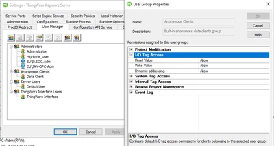

Okay so I had to select "allow here"
Kindly verify if you got the write permission, permission to make changes?

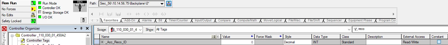

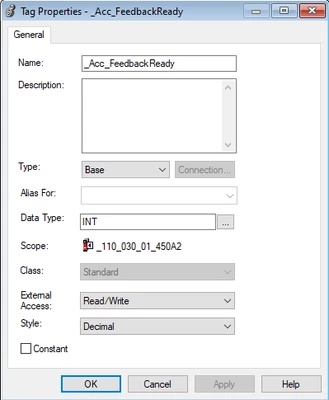

Do you mean this? Or some settings in PLC?
In PLC Read/Write is set
Okay, I think i know what might be the issue. I'll try to solve this case on Monday and let you know.
