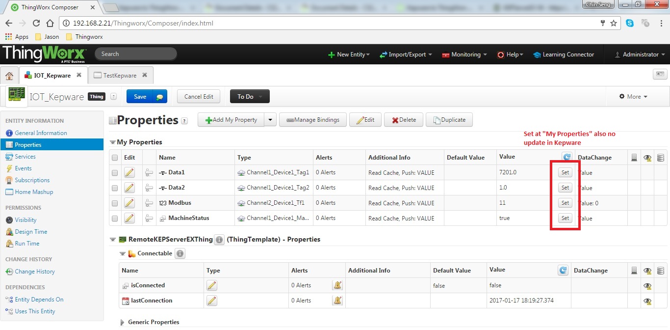

Hi All,
I can read the value from Kepware by using RemoteKEPServerExThing template.
But i dont know what is the correct way to write the value to Kepware in Mashup?
I also tried to write the value to Kepware from "My properties", the value is no update on Kepware

If you are using the Simdemo project (loaded by KEPServerEX after install), Channel1_Device1_Tag1 should have a Base Type of INTEGER.  This may not be the problem, but I see you are using a STRING.  Once corrected, writes on the Property pages still need to be refreshed using the blue icon.  Remember to check the KEPServerEX Event Log for errors.
In the Mashup, add a Data Entity that points to GetProperties of the KEPServerEX (IOT_Kepware in your case) thing.  For a quick test, add a LED Display Widget and select Configure Bindings > Binding Sources then add Data1 as a binding.

I already changed into integer but still not able to set it on the Property page.
For the step below, can i write value into Kepware? (I want to write to kepware)
