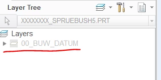

When I insert parts from EMX and I hereafter open the parts, the datums are always hidden in layers. In the layer its called 00_buw_datum. QST: Why are these datums always hidden. Everytime i import a part and i want to use the predefined datumplanes, I have to unhide and save status afterwards. Is there a way for these datums to always be visible? Thanks. Clement

Hello Clement,
we hide this layer by default.
There are simply to many datums on this layer in a later design state.
The reason for this is that we add all datums that are created during the design process.
The recommend to keep it hidden.
Thomas

Please explain how this layer is to be used and what the BUW means. thanks
00_BUW_DATUM layer
Also do you know of any documentation about the current layering process and how its better than old versions.

Hello Together,
we are currently working on a new layer concept for EMX 10 which will completly replace the 00_BUW_DATUM conecpt with rulebased layers. I will keep you up to date.
