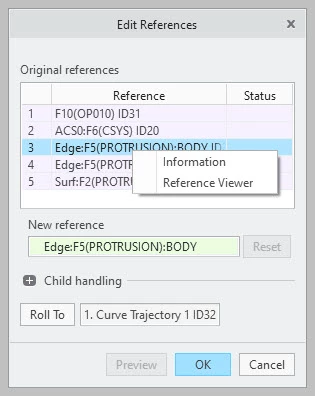

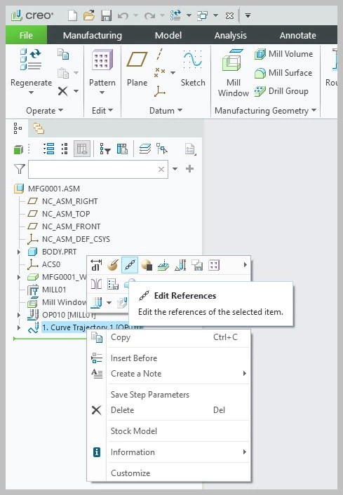

Add functionality to delete references used in an NC step by RMB step in model tree. See images.
I had the following request in today from a customer.
How do I delete the references used in an NC step, Using the references right mouse click doesn't allow the option.
Customer on Creo 4 F000, I have also tested on 10.0.2.0.
Only way seems to be to edit the Tool Motion entries.

I might be wrong, but I think the way to remove curves that have been used for a trajectory such as this, you need to edit the definition of the feature, then "unselect" the offending entities. That's how I will usually take care of things like a surface that is mistakenly included (usually an extra plane I didn't know I'd selected) or a bad hole axis, etc.
