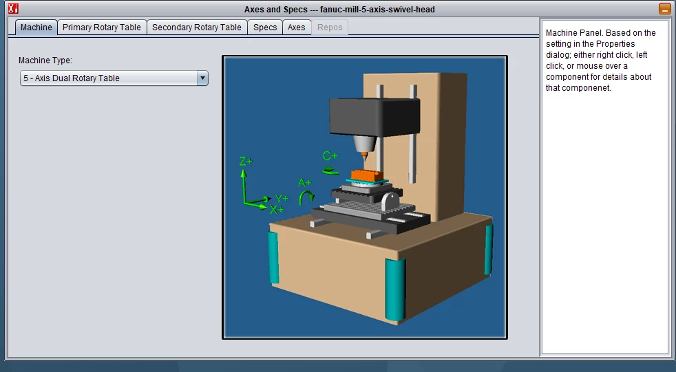

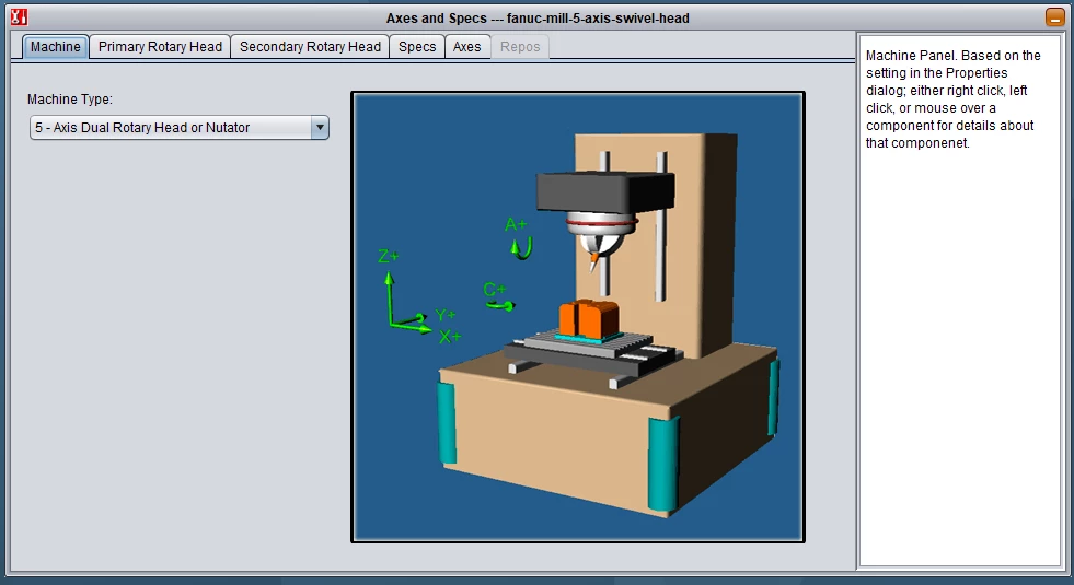

I am asif from Karachi, Pakistan i have a question about the Creo post processor. How to add Pivot distance in dual rotary table 5-axis machine with PTC Creo. and  Swivel-Type (Head-Head) 5-Axis CNC in creo post processor. Please check the pic of the machine configuration. i want to update the post processor for both machines. Please guide.
