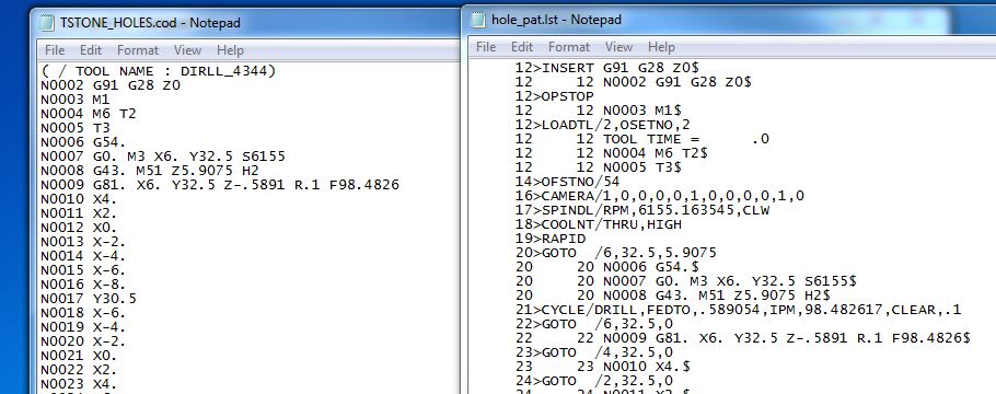

Hello all, I am putting together a post processor and want to add a G90 whenever a workoffset is called. I assume it is a FIL routine. Any help would be greatly appreciated.

This little chunk of code from my post-processor is how I handle the offset being set in the CIM file:
CIMFIL/ ON, SET, OFSETL
OFSTYP = POSTF ( 6, 5 )
OFSREG = POSTF ( 7, 5 )
IF ( OFSTYP .EQ. 1 ) THEN
IF ( OFSREG.GE.54.AND.OFSREG.LE.59.AND.CURREG.NE.OFSREG ) THEN
CURREG = OFSREG
OFSCMD = TEXT/ 'G', CONVI, OFSREG, 2, '$'
INSERT/ OFSCMD
ENDIF
ENDIF
CIMFIL/ OFF
Perhaps you could use this to add your own additional commands? The available documentation on doing this stuff is rather lacking. It's like some sort of arcane language.

In your FIL file you may try something like this:
CIMFIL/ON,OFSETL
DMY=POSTF(20)
POSTN/OUT,7,90
DMY=POSTF(21)
DMY=POSTF(13)
CIMFIL/OFF
CIMFIL is the way to capture certain commands in the CL file. In this particular example OFSETL
DMY is the return value for each function. I thas no particular use in this example.
POSTF(20) store the current command
POSTN/OUT,7,90 - output the G90 code
POSTF(21) recalls the stared command and POSTF(13) execute the command.
The G-post and FIL manuals are located in the <load-point>\<Machine-type>\gpost directory:
... Creo 2.0\Common Files\M110\x86e_win64\gpost\V64_GPost_CD_Manual.pdf
... Creo 2.0\Common Files\M110\x86e_win64\gpost\V64_FIL_CD_Manual.pdf
Look at section 2.5.1 in the FIL manual for more details about the CIMFIL routines.

I have been trying something similar (using INSERT instead of POSTN) but it seems to be ignored
Aug 27, 2014 8:33 PM UTC
It looks like you are trying to output the G91 G28 Z0 and M1 before each tool change? Is this correct?
