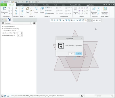

We use a tool from VK Engineering for auto save.
There you can choose if you want a real autosave oder only a reminder.
Have a look to the homepage:
https://www.vk-engineering.de/en/products/applications/vk-tools

Apr 5, 2024 5:25 PM UTC
We have implemented a small Tookit application that also offers an AUTOSAVE, among other things
If you are interested, just write a short message.
