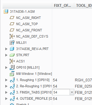

    Finally came up with a work around that is reasonably quick and intuitive but not as restrictive or complicated as editing FIL or site files, it still is not automatic. Also for there are times, R/A heads for example, we didn't want the 2 to be the same.
    You can alter the model tree to show the FIXT_OFFSET_REG in one of the columns. This can be edited in the model tree without having to open up the sequence parameters. The model tree configuration can be saved and then loaded every time (mdl_tree_cfg_file). I do wish there was a parameter to set these equal when desired. We tried setting the FIXT_OFFSET_REG = NC_SEQUENCE_CSYS_NAME but it didn't work.
