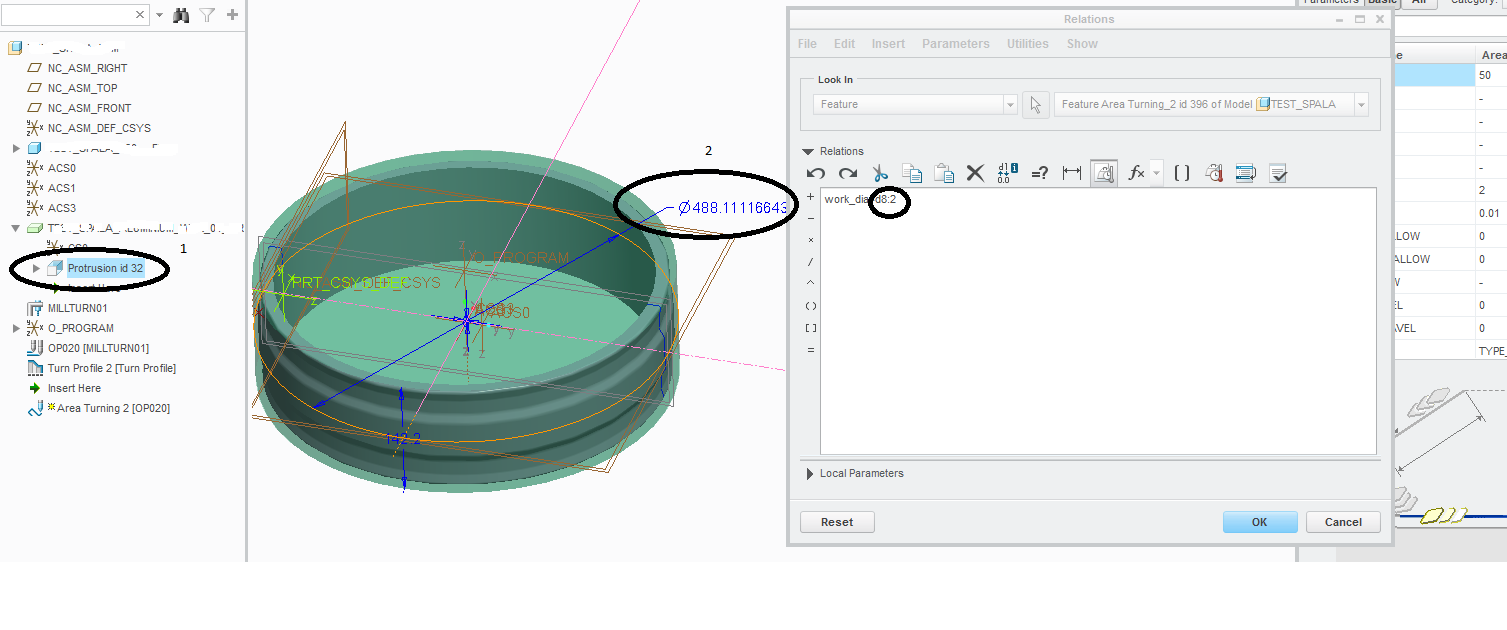

In a turning operation, I would like to use a variable CUT_FEED which is currently 10. This value should depend on the workpiece diameter:
- when ØA then CUT_FEED B
- when ØA/2 then CUT_FEED B*2
Cheers
Bob

    hi,
    inside parameters open edit machining parameters->select cut_feed and you ave "d=" it is symbol for equation-open it and write:
    work_dia=workpiece_dia:4
    if work_dia>=10
    cut_feed=15
    else
    cut_feed=5
    endif
    where work_dia is a parameter to workpieces diameter.
    br,
    ionut

    I understand the logic around but I got some errors with 'workpiece diameter' parameter. The workpiece diameter should vary with STEP_DEPTH.
    error Invalid symbol 'workpiece_dia:4' found.
    if work_dia>=10
    error Invalid symbol 'work_dia' found.
    cut_feed=15
    else
    cut_feed=5
    endif
    Thanks.

    when you write work_dia = "you have to select the revolve, extrude , or the feature from workpiece, then it will appear the dimension and you select that dimension" - in my case the was workpiece_dia:4 but usually it will be d3:2 or d8:2 someting like that.
