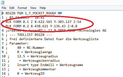

BLK FRM tool travel envelope
How add blk form in  post processor  Heainden 5 axis.

I don't believe this can be configured somewhere.
You will probably have to customize the postprocessor by FIL

     I am not able to solve that.Can you give me any suggestions regarding FIL language

If you ask for a solution to your issue, I have none at hand.
As for suggestions with FIL language in general:
  • If you do not have a lot of spare time to learn postprocessor customization by FIL (factory interface language - a programming language), better get help from a professional postprocessor specialist.
  • If you have the time, download example postprocessors and - maybe even better for the beginning - sample macros to learn from them
    • Keep the documentation about FIL ready to check on the syntax and options, to better understand what the macros do.
    • There are some macros that scan through the CLDATA for specific information - once you learned enough about FIL programming, you could for example rework one of them, remembering the minimum and maximum coordinates for the first tool position, then comparing/updating them for every move.
    • But maybe there are even better ways
