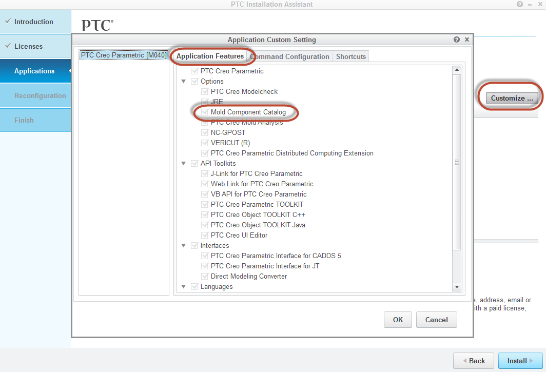

Brandon,
This is due to missing "Mold Component catalog" in your installation.
Reinstall Creo 3.0 and make sure you are checking "Mold Component Catalog" available under Customize > Application features to be installed.

Brandon,
Mar 25, 2018 3:53 AM UTC
Problem solved.
Thanks for your help.
