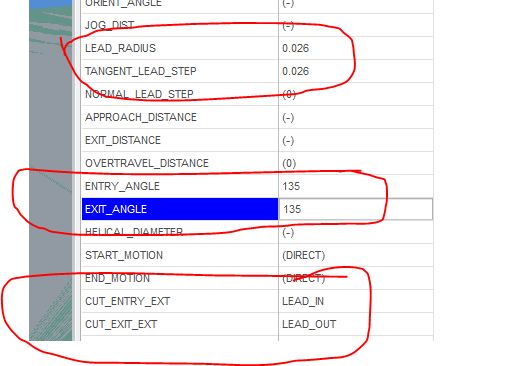

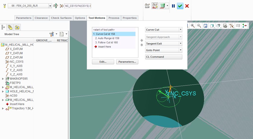

ive got to machine a chamfer on the back of a 25mm hole using a 16mm dia dovetail cutter,ive tried using trajectory milling but the cutter just comes down through the component,how do i get the cutter to come down in the centre of the hole then machine round the back of the hole.

this what I do to get any tool to start in the center of any diameter hole. take the hole diameter minus the tool diameter times .208 to get the leadin leadout amount. then set the entry angle and exit angle to 135.
In my example picture the hole diameter is .375 and the cutter diameter is .250 so the math is .375-.250=.125*.208=.026 this value goes in the lead_radius and tangent_lead_step as shown in the picture.
As you can see in the picture it makes an nice entry and exit back to the center of the hole.
