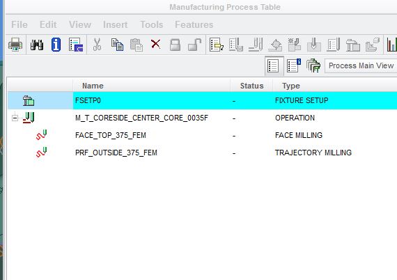

    Jason,
    the easiest way to copy sequences to a new operation is with the process manager.
    the above picture is my current operation.

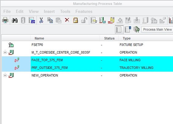

    new operation setup.

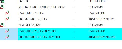

    Then just go to the edit menu and copy and paste from the first operation to the new operation. It renames the sequences for you so the names don't conflict. the only thing you might have to do is go into the sequences and change the coodinate system and retract if the orientation of the part to be machine changes like top to bottom.
