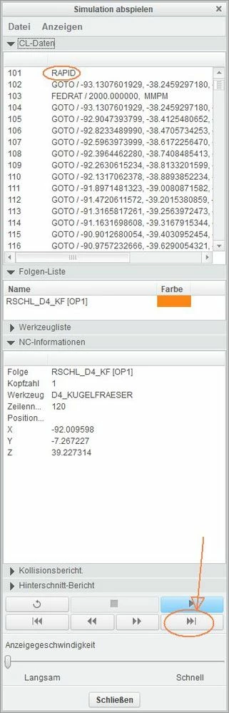

Does anyone know how to adjust the CL tool path player simulation speed.
With the slider set to as slow as possible, it is way too fast to see anything useful, there must be a way to alter the playback speed of the tool path player.

Slower than to the very left is not possible (not that I know of).
But you can go through the program step by step klicking to the encircled button at the bottom right.
And remember: The Rapid moves are done instantly. You can not see them. See the encircled RAPID at the cl-data window.
BIG P.S.:
What I use is the material removal. It runs slower.
If you just look at the path, you can use that tool path simulation becaue it runs so fast.
if you want a HUUGE slowdown, activate the WIREFRAME view.
The framerate drops very much. THIS WILL HELP YOU!

Check your feed rate. The player uses this value to determine the playback speed. If it’s too high than it will play fast.
