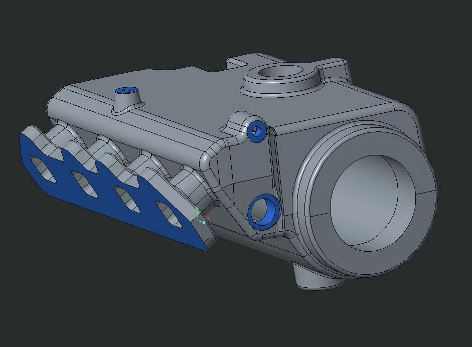

I would like to make all solid surfaces one color and the part another. This way when I use inheritance and make all the machined cuts there is a contrastin color automatically showing the machined features.
Is this possible?

Yes, I do this all the time.
1. set the part color (whole part) to the color you want for your machined surfaces.
2. select all solid geometry surfaces (to do this, select one surface, then right click and use the select solid surfaces (looks like a white cube with no text)
3. add the unmachined color to the solid surfaces.
When you create features that remove material, the exposed material is a different color.
